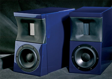

Sau cei de la Manger
http://www.6moons.com/audioreviews/manger/manger.html" onclick="window.open(this.href);return false;

Sau cei de la Raidho cu vechea serie Eben:
Triangle Magellan Concerto 2; AQ Everest; Vitus Audio SS-010 Mk2; AQ Dragon HC; AQ WEL XLR; Chord Qutest w UpTone JS-2; SOtM tX-USBultra & Paul Hynes SR5-12XL; AQ Diamond USB; Gryphon PowerZone; Stillpoints UltraSS; Solid Tech Hybrid
