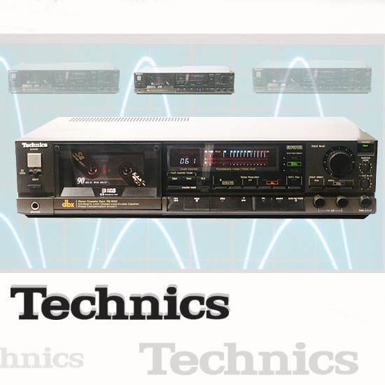

Technics RS-9900, o minune tehnica din 1977:
http://www.audioinnovationen.de/html/te ... -9900.html" onclick="window.open(this.href);return false;
si alte poze frumoase: http://www.audio-extasa.eu/popup_add_im ... gesID=2886" onclick="window.open(this.href);return false;
si unul restaurat:
